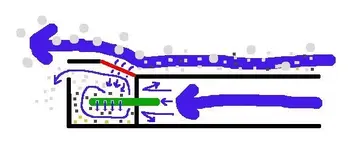

bazooka2.webp This maybe a little small. However, this is a simplfied way of how a Bazooka Gold Trap Works. The dirt, black sands, small gravel and gold drop down through the grating. The bottom tubes create the fluid bed.
Very nice and accurate Charlotee49er!
