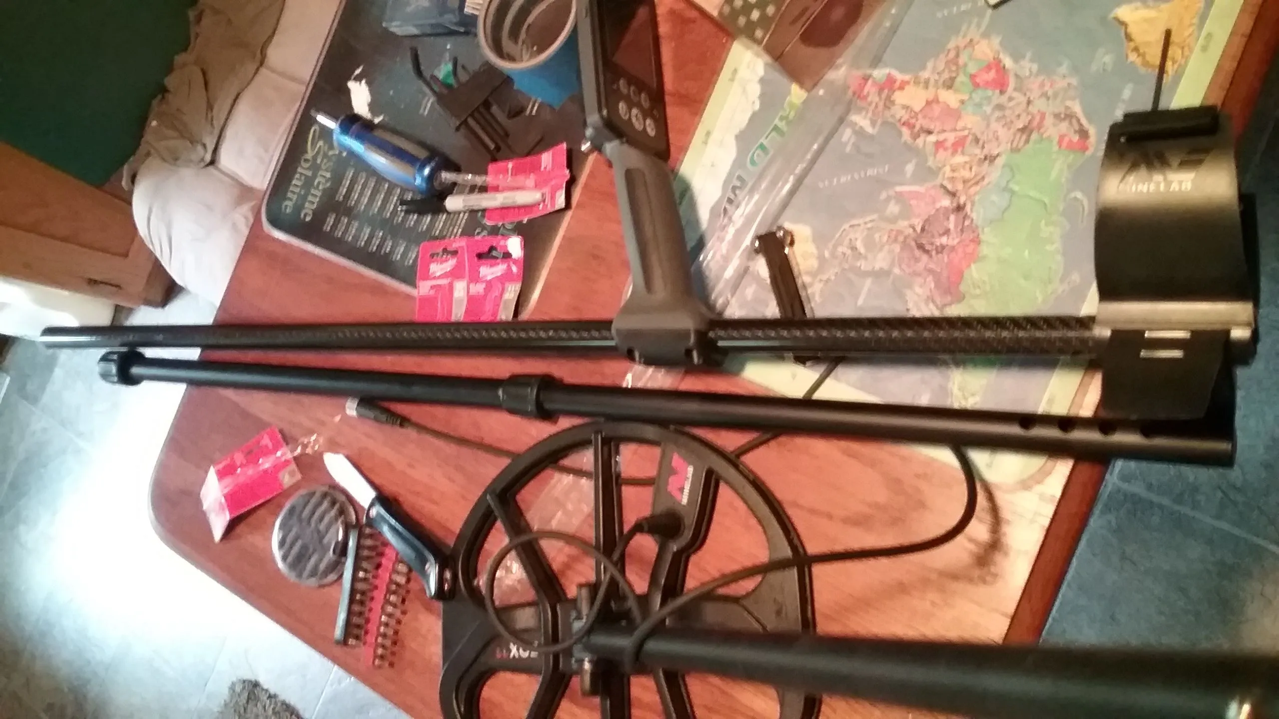

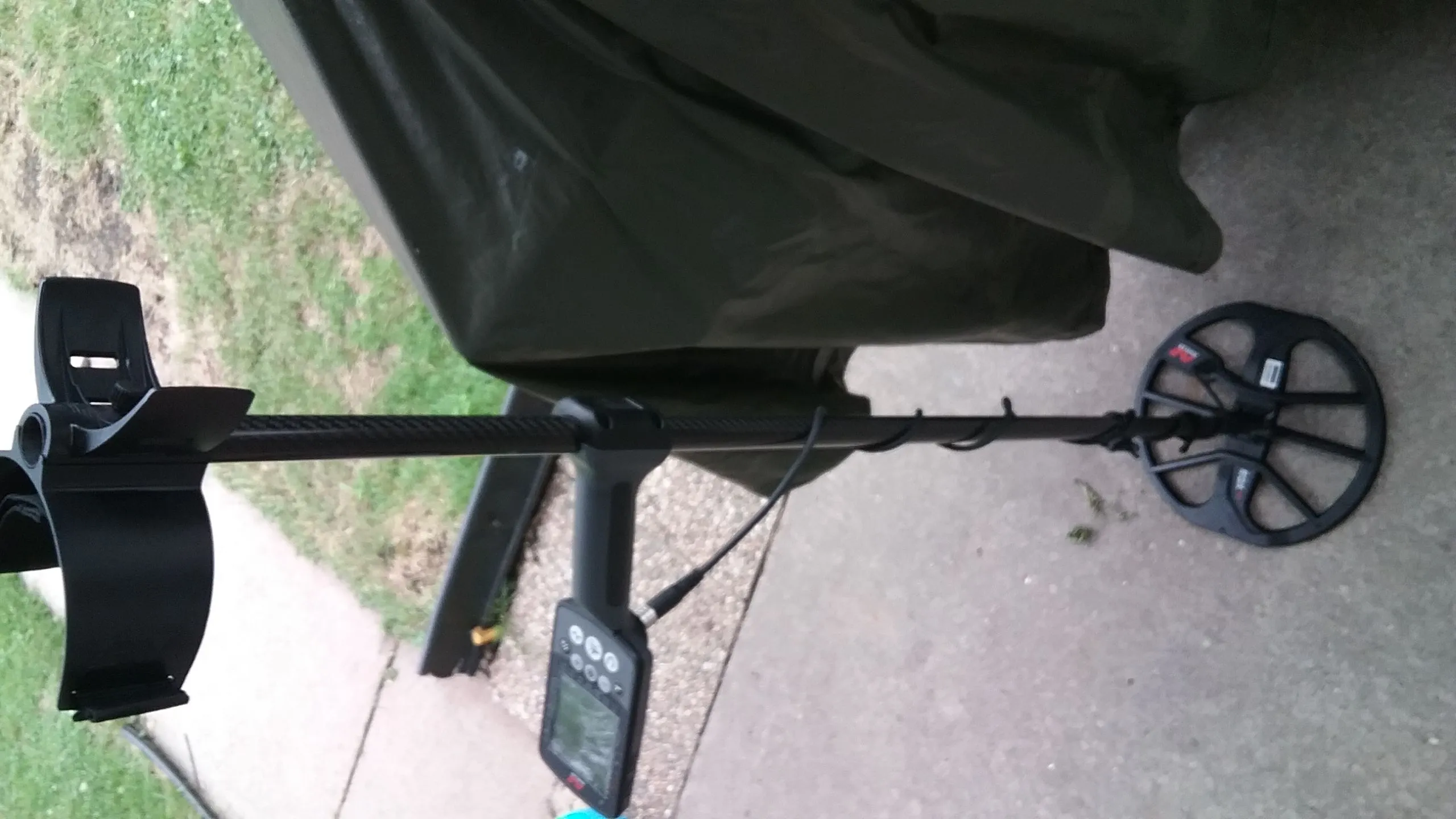

20180720_155508.webp did this in under 2 hours 20180720_154314.webp hand drill and didn' cut it down let it run wild to the coil end. Paintets tape and a chalk line, easy & fast.
