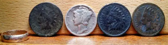

Got out for a few hours today and found all this. I hunted two spots, one of which I'd hunted before and found two of the IHPs I'd missed--the Deus came through again adjacent to collocated trash.
The ring is small and rang up copper, so it's either plated or gold filled. No markings other than an "A" on the inside. It was nice to pull the 1873 IHP...you never know what you're going to get at this place. I used a "yard" program which consisted of:
