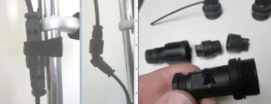

Will be testing this summer in the Saltwater, a great advance for the Excalibur and the Hunter...if they work
View attachment 940324View attachment 940325
Oh man OBN! If that works like I hope it does you and I are gonna have to talk about the NEXT project! I like it already....the 1000 could use that, along with the pinpoint mod......ability to swap coils AND still be water proof.....oh yeah!
OBN, I was looking at the type IP68-69, first model you displayed. Wasn't going to case mount it as they have a male/female pair and was going to do an inline method. The IP68/69 spec looks good as far as water intrusion goes for most of us.
Keep us informed sleeper if there is a short cut in finding something that all can do that would be great.
QBN and anyone else interested here is a link to a PDF catalog (small no big download) showing the connectors I found. IP68 rated, 10m depth for 2 weeks, more than enough for us. They are avial either with crimp or soldier pins or for those desiring screw terminals, my rec is the soldier pins, gold plated pins.
http://www.bulgin.co.uk/PDFs/Cat83_sections/Buccaneer-2010_mini.pdf
Hope the link works, let me know.
I have used those before with fair results around saltwater, I know a hunter who did use them a lot more then me and he said he hunted neck deep in fresh water with them with no issues. Keep us informed on your results.
