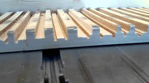

If I was being forced to use a wooden sluice it would be similar to one of these!!! And as soon as I found enough color I would be buying a lighter, and easier to clean out plastic drop riffle.
Those are nice that about what I want and I will upgrade to metal or plastic later.
This is on my "project" list. 36" x 10" maybe.
