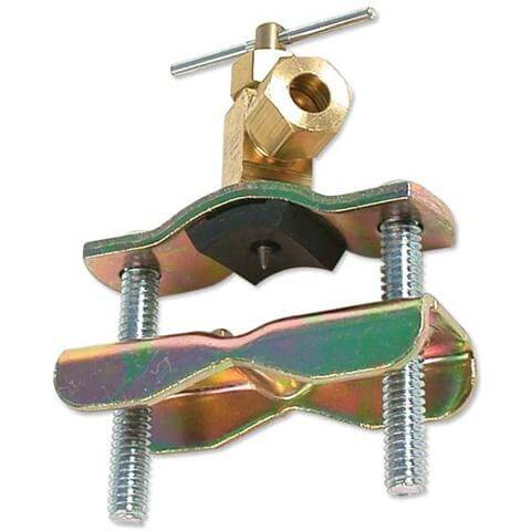

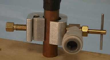

I think it maybe an aftermarket device for the DIYers similar to a saddle valve, and was use for tapping into existing water lines to add possibly another bathroom, etc.
It definitely seems to work like a saddle valve, it probably had a rubber or leather strip to seal inside the radius of the clamp portion.
