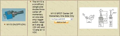

Mine went bad in my DeLeon. Don't want to pay shipping/repairs for a $5 switch, so I'll fix it myself. It was "stuck" in all-metal, and I've put a temporary switch in to at least give me disc/AM option, but no battery test. If anyone's replaced one, please let me know where you got it. I seldom use the battery test mode (which is momentary on the switch), but would still like it to function as designed. Thanks!
I'd give Tesoro a call and see if they'll sell you one. If not, have them tell you the name of the vendor that they get them from and the part number of the switch. I always ask for Rusty.
tabman
tabman

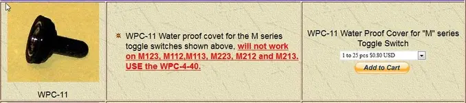

Thanks for the reply tabman! I knew I could find them somewhere cheap, just didn't know if anyone ever had the opportunity of needing one. I just found them, ordered 6 switches and 6 waterproof covers for $13.75 shipped. Figured I just as well get extras in case I'd ever need others, or someone nearby might.
ETA: Just realized the covers won't work with the switches, LOL, oh well.
http://www.led-switch.com/Miniature Toggle Switch.htm

Got an email today, letting me know I ordered the wrong covers, and letting me know of the correct ones. I think that's pretty nice of him to do that. So now, I'll be getting usable covers 8-)
So, just in case anyone needs the correct cover:
The WPC-11 will not work with the M113 as noted on the web page if you intend to use them with the M113 you need the WPC-4-40. I have made the manufacture aware of this and no fix is available at this time in the WPC-11 envelope.
