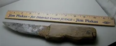

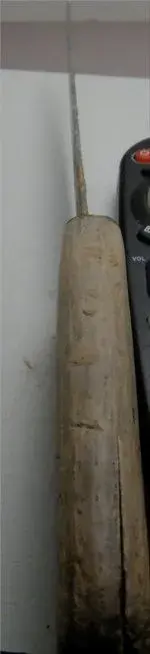

Because I have been fixing cars and trucks for over 44 years ( autobody and frame dude ) I have made many tools from various leaf springs and body files. If you find a small car at the junk yard with really narrow springs ( 1 1/2 to 2 inches ) you can make a decent digger. You will be cutting and bending one end for a handle, the other end is tapered to almost a knife edge anyways, just a touch-up with a file is all that is needed to sharpen. The autobody finishing files that are deemed not re-sharpenable by me, get turned into digging knives. These files are used for lead repairs and filing down high spots on sheet metal when you are metal finishing it. But first you have to heat it cherry red (do not quench!) So you can cut it to knife shape. Work the blade while it is in this grade. Grind as much of the original half round teeth off as you can, sharpen the blade, make sure you cut the tang into it. Here is a tip for right handers or left handers. Before re-tempering your blade, make a slight bend right or left so when you have it in your hand it is curved for you. After all the aforementioned steps have been done. I used a flame spreading tip on my oxy-acetalene set-up to heat the whole blade chrry red then, quickly douse it in a bucket of clean motor oil. While the blade is cooling, I went out to my wood pile and got a maple tree branch, on my band saw, I cut it to my personal length, then on my drill press I bored through the length of the branch. Then made the holes fit the thickness of my blade tang. I mixed up some J-B weld epoxy and poured it into the tang hole and inserted my knife tang, let it dry 24 to 36 hours, I dunked my handle into bright yellow liquid vinyl coating ( it has since worn off ). Pics to follow this post soon......NGE

As promised here's the pics of my knife, I have pried with it, cut roots, left it in a field for a year, it went through snow, a bushhog, and finally found it back again, just needed new handle. It is little worse for the wear..........NGE
BTW, the blade is only 1/16" thick and very strong....NGE
Nice work!

looks like an old cicle that has been cut down and beveld :sign13:
