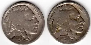

By the way, I read elsewhere that the active ingredient in nic-a-date is ferric chloride. This is the same chemical sold at Radio Shack for etching copper circuit boards. It is a pretty nasty acid and leaves stains on everything it touches. I'm not sure if nic-a-date leaves the same yellow stains but if it does be careful. It will stain your sink and toilet if you aren't careful. :wink: Also, don't use this on copper coins!
After hearing that it was basically just PC board etchant solution I went ahead and mixed up a small batch of my own solution: 1 part muriatic acid added to 2 parts hydrogen peroxide. I've been using this to make circuit boards instead of ferric chloride. It is much cheaper and doesn't stain as easily. Plus you can make it from readily available chemicals.
The results were probably similar to nic-a-date. Two dateless nickels yielded 1923 and 1925 dates within a few seconds of rubbing with a q-tip. And yes, the standard acid stain is also visible.
So if you have some muriatic acid and hydrogen peroxide laying around you can achieve the same effect as nic-a-date.

By the way, here are the two nickels that I used to test my homemade nic-a-date solution. You can tell from the pics that both of these were VERY well worn. I used the solution all over the nickel on the left. You can see that it looks etched all over. For the nickel on the right, I just dabbed the solution on the date portion.

Mts, that is exactly the stain that you will get from the nic-a-date. And Jeff's example above is exactly why it is a good idea to go ahead and restore the dates...
