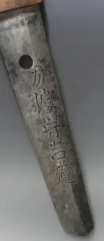

It is the handle end of a sword not sure of the age. The total lenght is 27" but the part in picture with writing is 5"Can someone please tell me what this represents or says or somewhere I may translate it. Thank You.
There are more markings on the handle you can see when disassembled. This sword was found in an older house after the it was burnt to the ground, Only part of the old house was standing. Like to have found this before the fire did. Thanks for all the information.

This is a "signature" added to Japanese swords. This one is known as "Tanba no Kami Yoshimichi" from 1661. Now the question of whether it is real or not. That is up to you to decide, so here is a sample of one being sold http://www.tokka.biz/soldSW/yoshimichi2.html
The thing to me is that the second from last character in your sample looks "crooked", whereas the samples I saw being sold looked more straight and solid. Here is another example. http://www.nipponto.co.jp/swords/KT110084.htm
Remember also that such signatures are sometimes found on both sides of the sword - your picture shows one side - wondering what the other side says, if any.
Price also really depends on the length of the sword as well. It takes an expert to check for authenticity.

The best way to tell is show us the whole blade,if you can see the folded/hammered metal marks like waves on the blade then it could be real,if they are a different color and texture than its a copy....
Re: asian language translation help
color of the steel looks good...although cleaned...a bad thing...
a simple way to check fake vs japanese made..pull the habaki off the blade...is it sharp under the habaki?
the people doing the fakes did not sharpen the entire blade.
