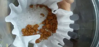

It is ore from Placer County, CA. The AuCl was actually orange. Some of the AuCl from this ore is yellow too. Both turn blackish when I add SMB then it clears. The precipitate is either super yellow, red yellow, or yellow-white. I did get avocado green from it once. It turns black when I melt it like silver chloride and gold powder.

This is what the other precipitate looked like from this same ore. Thanks.IMG_20170627_121137_01-2.webp
I was actually expecting variations. This is almost dried out.20170806_212112~2.webp

After SMB addition, NONE of my precipitates look like that! You are pulling something else out of that ore!
