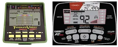

The AT Max is an AT Pro except it has a built in Linx wireless headphone system and runs a better freq then the AT Pro IMHO. The GTI 2500 is a dinosaur that likes a slow sweep speed. The Garrett detectors have a huge following and when I first stated I was interested in the AT Pro, but I'm just not a huge fan of their bell-tone. I mainly hunt yards in town and have never hunted in rivers or creeks, thus the waterproof feature is not on my list of requirements. I do have a water detector for the local fresh water beaches.

I have lots of hours on both the GTI 2500 and AT Series detectors. The true all metal mode on the GTI 2500 is very deep. The imaging feature, once learned properly, saves you a lot of time by digging only coin sized objects, leaving a lot of junk in the ground. There are several preset programs, to help with the type of hunts you do. The 2500 also has notching capalities, allowing you to selestively remove unwanted targets, or remove all targets except say, a lost earring where you might already know where it shows up on the ID scale. Below is a summery of the various programs/capabilities. On another note, the GTI 2500 is the only Garrett detector available, which supports the large 2 box search coil, used for searching for deep treasures like jars of coins or larger relics.
Field Test Of GTI 2500https://www.losttreasure.com/Home/FieldTestDetail/6202
For general hunting, including water hunting, the AT MAX is a great metal detector. The GTI 2500 is heavier then the AT MAX.
Unless you plan on adding a 2 box search coil and search for deep buried treasured, I suggest you stick with the AT Series.
Key Features GTI 2500
  • Graphic Target Imaging™ (GTI) shows true target size and depth.Watch "Imaging by Garrett" video
  • Graphic Target Analyzer™ (GTA) identifies target’s conductivity
  • True Digital Signal Processor™ (DSP) improves discrimination accuracy
  • ScanTrack™ optimizes treasure signals based on searchcoil swing speed
  • Ground Balance: automatic and also manually adjustable
  • All Metal, Non-Motion Deepseeking Mode: allows hovering over target
  • User-adjustable Volume, Threshold, Tone, Sensitivity, Discrimination
  • Salt Elimination Aid: eliminate interference caused by wetted salt at beach
  • Hip Mount Battery Pack: reduces detector weight for long searches
  • FastTrack™ Ground Balance for use in All Metal Mode
  • Surface Elimination: adjustable search aid ignores shallow, undesired items
  • LCD Backlight: to illuminate LCD screen for improved visibility
  • External Speaker and Headphone Jack: quarter-inch (1/4") size
  • Coin Alert Belltone Audio™: Garrett sound for high conductivity targets
  • Last Mode Switching: switch from All-Metal into last-used discrim. mode
Search Modes (6 plus electronic pinpointing)
  • All Metal
  • Zero
  • Jewelry
  • Custom
  • Relics
  • Coins
  • Pinpoint

Garrett's latest introduction model of metal detectors is the new "AT MAX." It was designed to posses the "best" options from both the AT Pro/AT Gold, and tweaked to squeeze out even more depth using the current available Garrett Search Coils. There are also after market coils available for those who even want to go deeper. The new "Garrett AT MAX." also included some entirely new features: Click on link for more information on the new features.
Garrett AT MAX Metal Detector
-NEW Built-in Z-Lynk™ Wireless Technology (Wireless Headphones included)
-Back light
-Optimized Frequency
-Higher Resolution Ground Balance
-Larger Display Numbers
-Volume Control
-Maximum Detection Depth ( significant depth increase)
And, included on the AT MAX are the "best" features from both the AT MAX and AT PRO:
-Iron Audio™
-True All Metal Iron Audio and Discriminate Mode
-Adjustable Frequency
-All Terrain Versatility
-Fully submersible to 10-foot (3 meter) depth. Weatherproof design also protects against dusty and humid environments.
-Digital Target ID–0 to 99 scale.
-High-Res Iron Discrimination
-44 points of iron resolution.
-Adjustable Threshold
-Pulse Width Modulation Audio results in sharp, responsive target signals
-Search Modes: True All-Metal, Custom, Coins, and Zero Discrim Modes.
-Fast Recovery Speed
-Notch Discrimination
-Coin Depth Indicator
-Battery Condition Indicator
-13.6 kHz Operating Frequency
