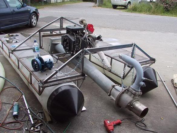

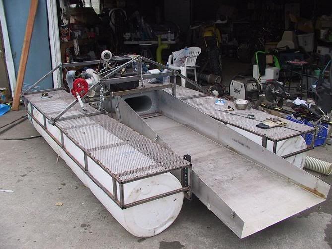

I have used plastic barrels on a 6" fast water build build. 8x 30 gal barrels were free from carwash. End caps are plastic pile caps avail in many different sizes. Use vent holes on topside. See pics

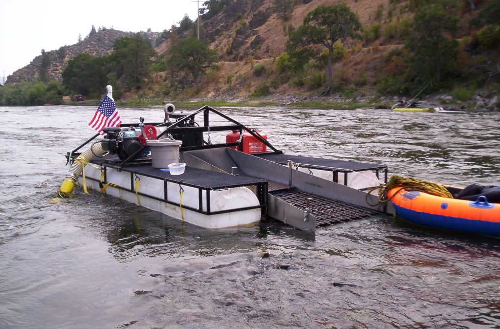

Thanks, god she's a floating high! In the second pic, the one in the water, I cant make out whats on the end of your box. Looks almost like square grating. Thanks for the pics,
Fast/deep water dredge by design... Meaning i could ladder up w weight belts on any corner or take it through rapids w paddles and not sink it. Design your floatation to meet your needs. The important part is down in water. Keep sluice low down as possible in water for best suction Square grating? Hmm maybe its the grizzly bars running down the riffles your talking about. The flare sluice caught fines best but i only made this one. Square as good and easier and lighter.
Hoser- not sure of those names.. I built that sluice from scratch as my dad has since mid 70's. You know this dredge buddy.. From the 49ermike daze.

I love your design, and I'm going to copy parts of it! Hope you don't mind.
How you had the lift system on the rear of your sluice was what I was considering but was going to do the front also so I could keep her up out of the water if I needed to move. Like how you also did that with your flare/jet.
It's prob the grizzly that I'm seeing. At my age, my eyesight isn't what it used to be! :laughing7: (square grating is aka cat walk)
Love the walkways over the pontoons. Could load up my coolers, camping gear for a extended dredge trip down river!
