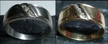

I have found more than just these two almost exact style channel rings with diamonds...this is a popular style of wedding ring.
The yellow 10k gold on the right came in at a 35 on my Fisher, just like a sta-tab.
The ring on the left which is 2 sizes larger, heavier and also 10k but white gold came in as a dead on 24....just like a condiment package or those hated round pull off freshness seals.
