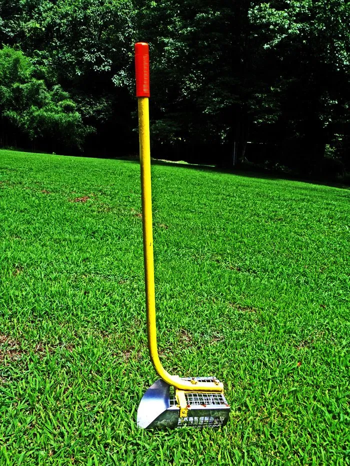

Here it is. Been using it for 14 or so years in wet and dry sand. It started out as a SS Jet hand held scoop from Kellyco. I added a piece of electrical conduit and coated it with that rubber dip used on hand tools. Added a handel bar grip. it will outlast me. Frank five star.webp

Here it is. Been using it for 14 or so years in wet and dry sand. It started out as a SS Jet hand held scoop from Kellyco. I added a piece of electrical conduit and coated it with that rubber dip used on hand tools. Added a handel bar grip. it will outlast me. FrankView attachment 1074718
That thing wouldn't last a week with me yanking on it! :laughing7:
