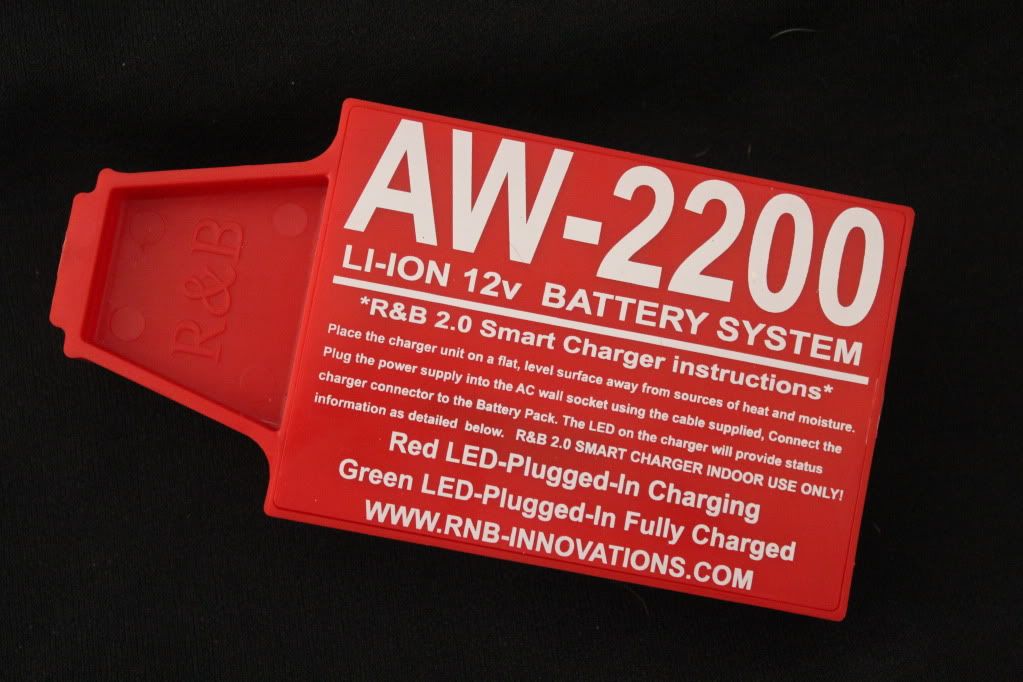

AW-2200 $134.95 Free Shipping with a Lifetime Guarantee!---------------Priceless
