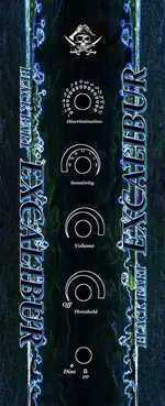

The file is big, I have to figure out where I can post it to download, they are photoshop files...they were test runs..one is lite color the other dark.. both got in some beach time and did very well..I will be doing a few more this winter..closer to stock..I would like to do one similar to the original sword model..let me check around for a place I can upload them, these were printed on vinyl...........And applied over one EMI copper shield, and one EMI Aluminum shielding..both worked, and I seen no difference in the two shieldongs. Like I said on the excal, and yours it seems...Some are hotter then others..the adjustments for that are on the third level PCB Board of the excalibur.....Give me a week and I'll see if I can get them to were they are downloadable

Don't worry over it too much oldbeechnut I can whip something up using google sketchup.
Some really nice decal work there OBN, let me know if you decide to sell any of them, I need to replace decal on one of mine....
OBN,
You're the master at Excal tweaks. Thanks for the information and the templates!
Thanks TH and DBs.................Treasure Hunter, these were printed on vinyl, alittle heavier material then the original blue decal..I'm not real happy with that and have located a vendor that can do them very close to the original material..it maybe early spring, but I hope to work up a couple more designs..some closer to stock. I know there are alot of older excal's needing that.........these were about 8 dollars each to have made, not to bad for a face lift ...Thanks for asking, I'll keep you informed........
