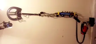

Yes, Aqua headphones, and the number is 198. I bought it from Mel Parker, and he said it was a Gary Storm model / New York model, apparently the first style of Minelab Excal. It is a good one, only problems were saltwater in battery connection-fixed with silicone grease, and where I cut the coil wire and put on a connector, bending the coil cable too tight-the coil cable is only about 42" long, and when I put in the connector and taped it to the body, the sharp bend over a year caused a wire to break inside. I took everything apart, and straightened out the wire and it works fine, I cant make it do what it was doing, but I plan to replace a majority of the coil cable with shielded Cat 6a patch cable, to stop crosstalk and extend the cable so I can use a straight shaft and have the control unit behind my elbow. I dont know why they would make it with non-shielded transmit and receive. Another weak spot in this unit, the non-shielded wires, and the lousy loose jacket. I know most strong PI units have shielded coil cables so the they dont have alien crosstalk and crosstalk, they only want it to receive through the coil, not the cable.

Steve that is great, No.198...I have PCB No.200, my Sword Excal has a Gold Handle.
