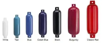

PVC sounds heavy. When I looked around for DIY methods, I spotted boat fenders at Cabelas
Sure seem like they'd take a beating. Fiberglassing is relatively easy to do, but I suspect a good whack on a rock will end up with a crack.
They (cabela's) also had platoon floats for fishing, which seemed like they could work. They had one set on sale, but I don't see it online offhand.
