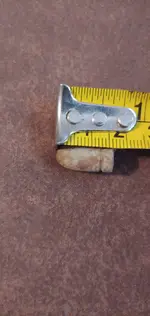

My wife found this today in a field where there was a Civil War camp. Anyone know If this would be Civil War? Any help would be appreciated! ADE937C4-33DE-4F84-955E-16383D061F8E.webpBEE2D4D3-3889-4BF5-B079-9846BF3B7C21.webp
What is the caliber and length? It's a "maybe" without measurements.
If it has a solid flat base, my guess is a 9mm. pistol round.

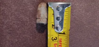

D3A1D301-47D1-4129-A118-19B90758E025.webpCFEC4A6D-92CF-486B-87DD-604F0F4FE73E.webpThanks guys! Here’s some more pics of its size. Not sure how to figure out caliber
Here’s a couple of the base. Don’t mind my dirty nails just got in from detecting lol
without knowing an exact measurement there's not much we can do, I'd guess .32 long just compared to your fingers and early 1900's maybe
Hey man forgot to attach pictures of me measuring it but I edited my post and they are on here now . QUOTE=NOLA_Ken;6447567]without knowing an exact measurement there's not much we can do, I'd guess .32 long just compared to your fingers and early 1900's maybe[/QUOTE]
View attachment 1809349View attachment 1809350Thanks guys! Here’s some more pics of its size. Not sure how to figure out caliber
Caliber is just the diameter in 100ths of an inch. That bullet looks to be about 3/8" which would be .375 caliber. You can measure the diameter with a caliper. If you don't have a caliper you could a pair of 1/2" square sticks along each side and your tape measure to get an estimate in 1/16ths of an inch. Without a diameter any answer to your question will be pretty much a guess.
I used my caliper and your tape measure in the photo to guess it is about .375", which could have been fired from a .36 caliber pistol but I wouldn't get my hopes up because both 9mm and .38 caliber modern cartridges also measure 3/8".
