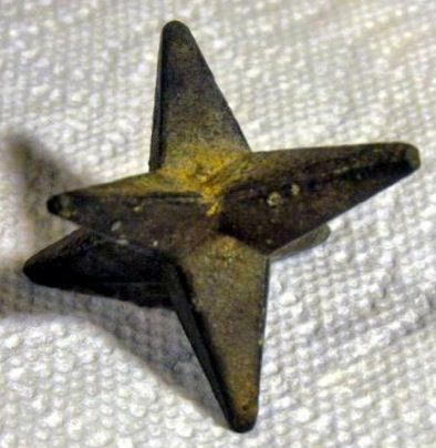

For many years, these things have been identified as caltrops ... they have been identified as jacks .. they have been identified as tumbler media .. They have been identified as jackstones.
Many posts about these things have been posted right here on the What Is It Forum, and their use has been debated over and over again. I won't go through all the related threads, but if you search for "caltrop" you will discover quite a few debates. I have participated in many myself. This is the item I am talking about:

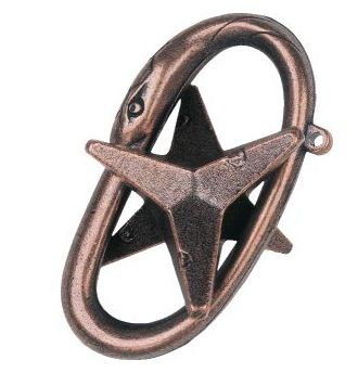

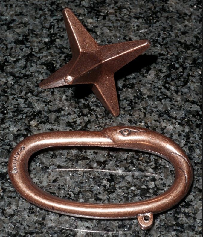

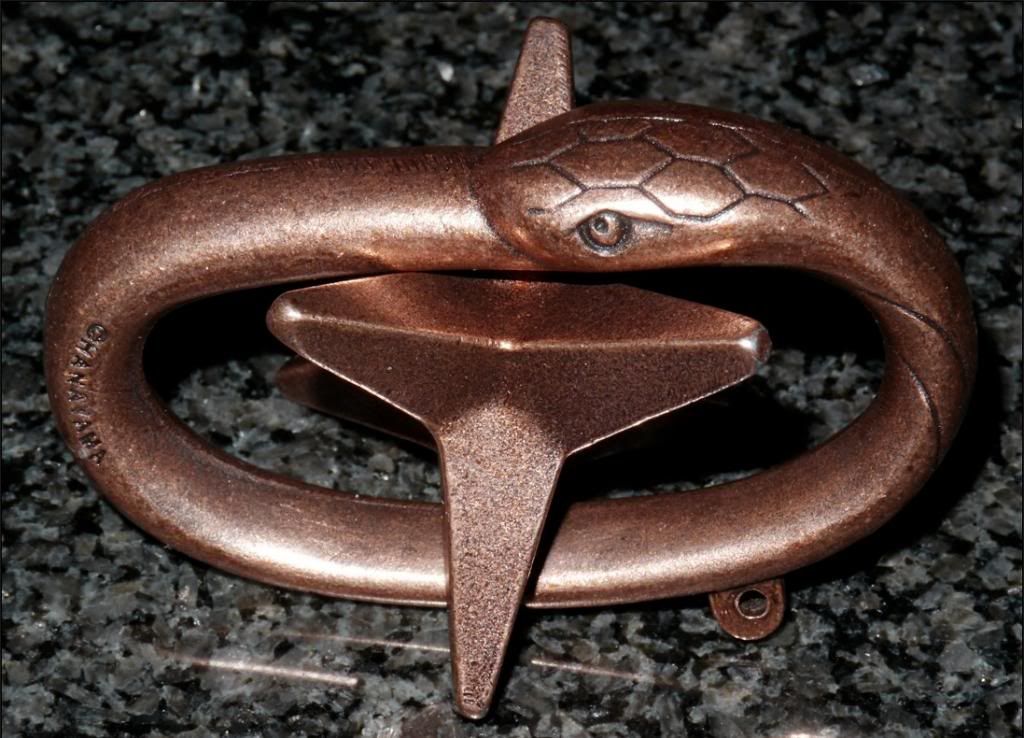

For years I have searched for their true identity, and this evening, I think I have found just that. If not, it certainly is another factor to throw into the equation. These pieces are (or could be) part of a 19th century "Serpent and Star" puzzle as shown here:
I hope this post will be helpful in the debate on these caltrops that aren't caltrops.

I am curious about that , Pete. Assuming these were made of iron, and assuming that they were magnetic as stated, how would they work in a tumbling application. It seems to me that if they were magnetic as stated, they would cluster together in a blob and become ineffective. Additionally, I am curious what the castings were made of that were put into the tumblers along with these things? If it was anything softer than the iron, these things would beat the daylights out of the softer metals, wouldn't they? If the cast items were say, cast iron, and put in with these magnetic stars, wouldn't the stars stick to the cast iron pieces rendering them ineffective?
Also, I am not sure what the original Serpent & Star puzzles were made out of, but their origins apparently stem from 19th century Britain.
I already asked Fmerg for details, in a private message. By "magnetic" he meant they these Mill-Stars are made of iron/steel. You'd use a magnet to retreive them out of the loose material in the tumbler-mill when the stars' work was completed.
Your guess is correct... iron ones are used to clean iron/steel castings. Softer-metal stars, like the brass ones, are used to clean brass objects.
Explanation:
When a cast metal object comes out of the mold, it typically has bits of moldcasting sand (from the sand-mold), "flashing" (slivers of metal which extended into the seam between the mold's two halves), and burrs and "slag" (resulting from some of the molten metal fusing with the casting sand) on its body. You can either very laboriously clean all those imperfections off of each casting... or you can dump a bunch of castings into a Tumbler-Mill (basiclaly, a barrel which rotates on its axis, like a barrel rolling downhill) along with a bunch of these Mill-Stars (which are a variety of Tumbler-Media), and set it to rotating. As the tumblermill's barrel rotates, its contents continually tumble onto each other. The points of the stars batter off the surface imperfections and casting-sand remnants on the body of the castings. The points also reach into inverse angles and other recesses on the castings. When the cleaning is completed, your remove the castings from the tumbler-mill, and then instead of having to dig through the sand, burrs, and slag, you use a magnet on a stick to retrieve the Mill-Stars.
We're now seeing a lot of "surplus" iron Mill-Stars turning up because of the advent of superior Ceramic tumbler-Media. Also, there's not as much ironcasting going on in American Industry as there used to be, because businesses can get it done more cheaply in foreign countries, such as Mexico.
A related example of "surplus" Mill-Stars is the sale of them as Jacks (for the children's game Balls-&-Jacks) during the 1930s Great Depression. Lots of casting-foundries went out of business, and somebody figured out a way to turn the un-needed Mill-Stars into money. As I mentioned in a previous post, a seller of antique toys & games on Ebay had an Original cloth bag marked "Arcade [brand] Jacks" -- it contained a mix of Mill-Stars and the usual Jacks from that game.
After further research and measurements if have concluded this item to be part of the serpent and star puzzle as described by Creskol. Subtle differences in the size of the six seemingly equal points in a casting that could have been made perfectly equal are the clincher in my book. The material is (as described) non-magnetic and could be a variety of alloys. The depth and patina have me believing it could be 19th century but that is not as important as knowing what it is. I am ordering a new puzzle and will keep them together as a set. I will not try to remove the star from the serpent because that must have been what happened to the owner of the original since I never found the serpent part. I have marked as "solved" and now may rest...............thanks again, dave
