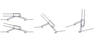

Gonna add to the mix - here's what it would look like going through its motions under tension
Unlike the other stretchers, this one's handle extends through the head and would inhibit the range of motion for the arm on the right side. Kinda impractical for pulling two wires together to be joined if they wind up so out of line.
