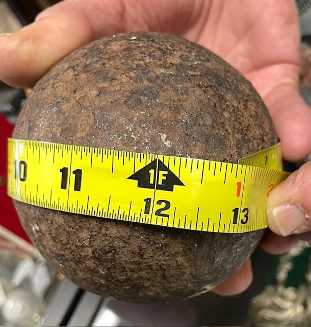

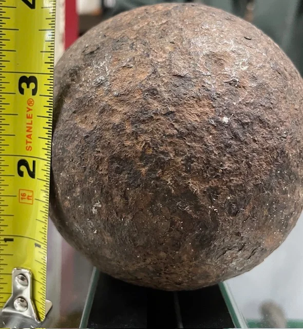

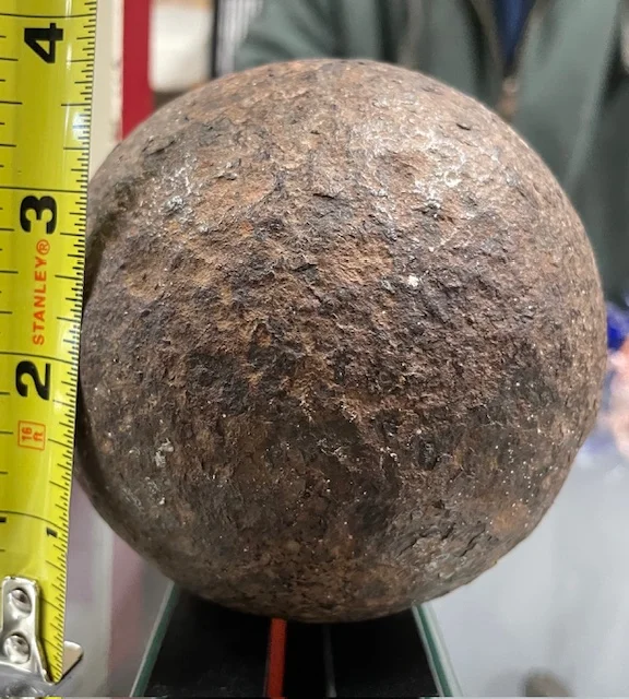

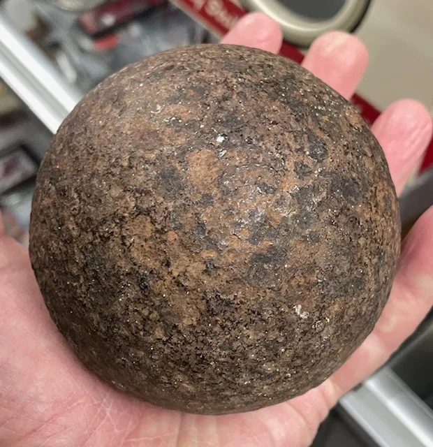

Hello
A Friend has this ball, he purchased years ago from a finder In CT who said it may be Revolutionary war, as The Brits burned down this Town
it is solid and a good weight, no makings, seems to be just under 3 3/4" diameter, and circumference 12 7/8 +/-
that's all I have,
maybe have a look at photos and dimensions
I am curious what it might be and if it is an actual cannonball if its Revolutionary war or 1812 or Civil war
let me know if you need more decent photos
Thanks in advance

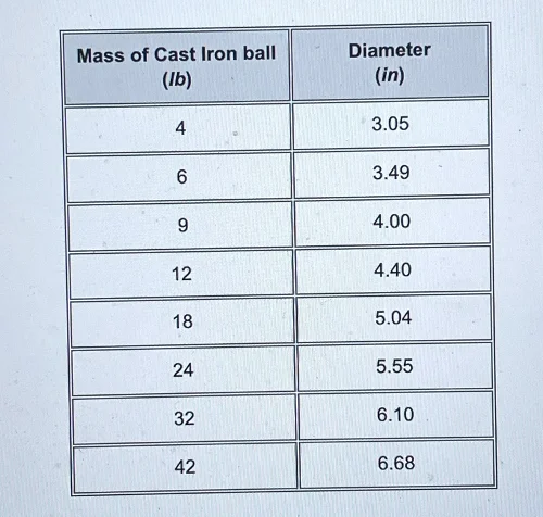

He was, and could likely answer your question without a follow up. Not sure the rest of us can. I have seen TCBG post some official measurement/weight documents from the military (at the time). I’m not going to dig back through to find them. (Sorry). Only thing I’ll leave you with from Pete…..it can always weigh less (air bubbles in casting), but it can never weigh more. Best of luck.
From The CannonballGuy
Just confirming the chart for Rev War, I am looking for is the following​
"Descriptions of Solid Shot for Smoothbore Guns"​

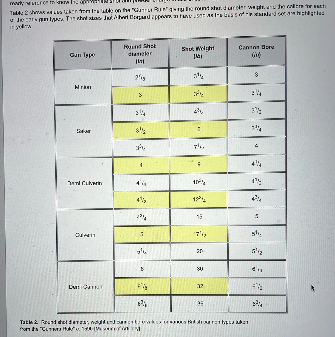

I do believe that would probably be the right chart, if yours is an American civil war cannon ball, if it's earlier, Revolutionary war or 1812 it could most likely be British or French and you need would another chart since America wasn't making their own cannons yet...BUT before you start looking at any chart you need a very precise measurement and weight, as both will be needed and they both have to match up in the chart.
Here's a link for British shot.

I just measured it as instructed and had it weighed at post office
Diameter is 3 15/16". weight 8lb 12.4 oz
it seems to line up with British 9 pounder , the chart lists at 4" diameter and 9lbs
I am not that concerned with minor difference with diameter and weight
citing from a great link I got from one of Canon ball guys posting
Solid Shot Essentials: A Guide to the Authentic and Non-Authentic​
David Poche with Peter George
"Caveat:
The diameter of any solid shot may be altered by the effects of pitting or scaling of its surface, and exposure to acidic ground water. Both effects may make it lighter.
It should be pointed out here that with only one exception, no military solid shot was ever fabricated at a diameter equal to a ruler fraction (1/4, ½, ¾ or an even 1). Ruler-fractioned objects are all civilian rather than military and a quick glance back at the Shot Table diameters will confirm this. The single exception is the 32 Pdr. caliber cannonball, whose specified diameter was 6.25 inches. If an iron ball is encountered that has a diameter equal to a ruler fraction, like 3 and ½ inches (3.50) then it is not authentic.
Also when comparing with the Ordnance Manual’s specified weights for cast iron shot, remember that cast iron molding inherently creates bubbles inside the casting. Internal casting bubbles will make the solid shot lighter.
Authentic cast iron solid shot may be lighter than the Ordnance Manual Shot Table weight but it can never be heavier. If a particular shot has the correct diameter but is heavier than the weight listed in the Shot Tables, then it is probably steel.
The weight of a military solid shot is never specified to be an even pound. If an iron ball is encountered with an even pound weight, such as 3.0 or 4.0 pounds then it is not authentic and points to civilian. The exceptions to this rule are 8 inch and larger caliber solid shot, but that is because the Ordnance Department was not concerned with specifying ounces at such great weights (65 pounds and up).
