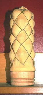

In addition to a Stand Of Grapehot, there was another version, called Quilted Grapehot. The name "Quilted" came from the look of the canvas fabric wrapping being held in place by a wire mesh, giving it the look of a quilt.

Quilted Grapeshot, 3.25"-caliber, non-excavated condition, showing original canvas with wire wrapping.
