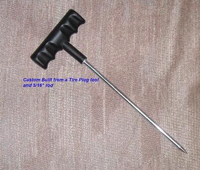

Hea Dan i took some 5/16" rod and the reamer that is used when
installing plugs into a tire and heated up the rod that has that checkered
edge on the side for cleaning out the hole in the tire before installing
the plug into the tire
and installed a 10 1/4" rod into the handle, take a 5/16" tap and die and roughen up
the inside of the handle and out side of the rod for better holding power for the Epoxy
will be drilling a hole in the end and use a washer and small nylon cord for a lanyard.
It really helps hold the PLUG from trying to flop back into the hole as your
trying to dig GTEAT ;D ;D ;D ;D Invention and well worth the money to
Invest in ONE :thumbsup:
