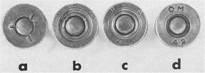

Look at B in the picture below. The crimps aren't as distinct, but they're there. This was found at http://www.frfrogspad.com/miscelln.htm
A - Stab crimp, B - Circular stake crimp, circa WWI, C - Circular stake crimp, circa WWII,
D - US Military crimp
