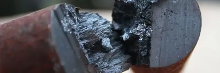

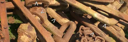

In the picture of your chain, the visible grain is circled. In the next picture of scrap iron, the visible grain is pointed at using v's, and the last picture, a wrought iron rod has been cut half way, then broken, and you can see the grain like stump pull when you cut down a tree.
