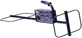

I am wondering if you could or if someone has tried to waterproof a 2 box detector for diving instead of using a mag behind a boat. Could you use a basic Discovery TF 900 or similar product and waterproof its control box and scuba with it in the ocean environment?
Why would you want to?
Even an average quality proton magnetometer is much more sensitive and has a far better range than any two box detector for finding ferrous material.
The Aqapulse detector with the 15 inch coil would reach as deep or probably deeper than a "waterproofed two box."
JW Fisher makes a decent boat towed pulse induction metal detector.
Geometrics, JW Fisher, Aquascan International and Quatrosensing all make some good diver held magnetometers.
The TF 900 is a VLF machine. It would work OK in fresh water but not so good in salt water. Better bet would be a Pulse Induction machine. Best bet would be a proton mag as others have stated here.

Darren, what do you think about the TF900? Will it do what I want in a swamp as long as it stays out of the water?
I don't see why not if you're in shallow water. Brackish or salt water will be a problem for this machine, but not for a pulse induction unit. Shallow freshwater should be fine. My recommendation is that you become proficient with it on land before trying it out in the water. Like all detectors, it takes practice to learn what it's trying to tell you, but this is more true with a two-box. Digging in a swamp environment would be a hard place to learn. Bring an intertube or friend with you to help keep things dry. All the best to your venture.
