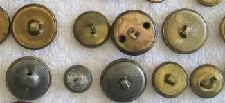

Even if it was possible to clean up this rust, these type of steel back fashion buttons rarely have any backmark. I say rarely because I have seen a couple backmarked steel buttons in my lifetime but the far majority are simply blank.
