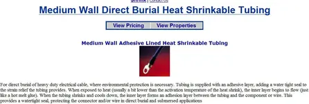

On the coil cable I would recommend using 3 n 1 shrink tubing or I can post a link for the wire that is used, just need to know how many wires are in the shell.
**Link Removed at Heat/Shrink Site Request**
Continuous-Flex Multi Conductor Cable Unshielded, 20/4 AWG, .25"

Since it is a PI, they sell shielded coil wire also, but it is a task to get a perfect splice.
