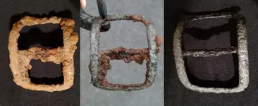

My favorite find was an iron shoe buckle found at the virgin colonial site the me and the rest of the Basstards of Bramble detected in April. Here's a before
Absolutely beautiful. When Brad did electrolysis on the buckle, he realized it had a pewter finish on the front. It was super difficult to work with but holy ****it looks great!!!

Thanks Bill. What a good guy. I mailed him very scarce beer (Dogfish IPA 120), but perhaps I should have mailed him more. What he did on my iron shoe buckle (a bucket list find and what I affectionately call "my baby") is beyond anything I expected.
Steve, you're more than welcome dude. And Bill, that means a whole lot to me, since I have learned a ton from you.
Here's a picture of the buckle before, during and after.
