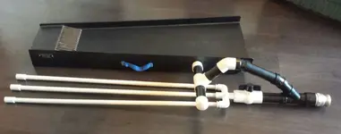

Has anyone converted their bazooka Miner sluice to a highbanker?
As I recall Good Guy converted a smaller Bazooka. I have the 48" Miner and would like to try the same with it. A temporary conversion so I can switch it back to a stream sluice. I have had it for 3 yrs & never used it yet but as I stared at it yesterday & was playing with it & remembering it's bulk & what it weighed, I thought portability is NOT it's strong point & it might make a great highbanker.
If anyone has done it I would love to know what you used for a pump etc. PICTURES would be a HUGE help.

But it's a fairly simple conversion.
You will need to fabricate a 5 tube manifold to run water into the trap with it's own control valve.
or else figure out a way to make a removable water tight cover to close off the end of the scoop and install a control valve into it.
As far as the pump goes I used a 2" pump from harbor freight on mine which would also provide enough flow to run the 48" miner.
See if these photos give you a better idea.........
Please post photos of your conversion when finished.

GG, this is more what I was thinking and those are the pics I remember. Thank you!
I was thinking more of the removable cover to close off the end of the scoop. Easiest example being a 2x4 with tapered ends cut to fit tightly and held in with a couple screws. A hole cut in the center & a 2" floor flange with the proper fitting for the pressure hose to feed, or if I get fancy I can fabricate it some aluminum plate. Then a hopper assembly with spray bar so I have 3' of slickplate in the sluice with material classified down to .5" or so... Make sense?

Closing off the end of the scoop should allow for a more even flow into the fluidizing tubes once the compartment is filled :icon_thumright:
I experimented with several spray bar and grizzly arrangements including creating the hopper from scratch. I also created an attachment for dredging.
Would not recommend dredging into any size Bazooka as the flow required to dredge would overwhelm the fluid bed and lead to scouring.
That is the problem I encountered with mine and was not able to solve it without a total redesign. Which led me to create the "super fluid bed high banker dredge" pictured below.....

If you add the highbanker mods to the Bazooka you will be able to regulate the flow into your sluice and gold trap individually to fine tune your results. Comes in very handy when the water flow in the stream does not fit into the window of the Bazookas optimal performance range. Also you can run the Bazooka almost flat which enhances it's performance as well.
Personally, I believe that the 48"miner with the highbanker mods will out perform the A52 highbanker both in production as well as recovery. (even with the cheap green mat installed in the A52)
