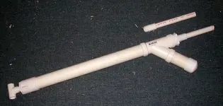

What a coincidence. I'm making one today. I went to Lowes on my lunch break and got a few parts. I already had some PVC pipe, cement, and some odds and ends at home. I watched a few 'how to' videos on YouTube. Going to change the plans slightly so I can use the PVC pipe I already have.

This is what I just made. I used a threaded reducer at the end so I could make some different tips; angled one and kept the other flat. Already thinking about things I would change. Most of the plans online used 1 1/2" PVC. I had 2" at home, so I went with that. I spent $11 on parts, so I can't complain. Now I just need a field test.
<img src="http://www.treasurenet.com/forums/attachment.php?attachmentid=686251"/>
You will find out quickly that filling and emptying that "cup" that holds the pay dirt is very time consuming and frustrating.
I have a gold and sand. Sucks from bed rock through the pump and a hose to a small (2-3 gallon) bucket. Much easier and better time spent concentrating on one spot. Just remember to flush the tube well, it may hold gold.
Eventually I'd like to get one of those X-Stream HYBRID Hand Dredges. It looks nice. I just don't have a spare $119 at the moment. Plus, I wanted to try something before the end of the season. It's already snowed here twice.
When I was checking plans online, the first did not have that 'Y' adapter and cup. It suggested to quickly pump back and then tip the dredge to prevent the pay dirt from falling out. Another one I saw had a string and rubber ball at the end. When you got to the full extent of pulling the handle back, the ball would plug the hole and prevent anything from falling out. Then I saw the one with the 'Y' attachment and the directions to empty the cup. I had extra 2" PVC and made a longer cup to bring, because it does look like a pain to repeatedly empty it out. The last video I watched was the same design, but the guy emptied it without removing the cup. He brought the hand dredge to a bucket with some water, turned it so the 'Y' was on top, and then pumped it out. Gravity caused the pay dirt to come out of the cup without removing the actual cup. Still, a lot of filling and emptying. Last time I was at the Wild AM in NH, I was reaching into 18" of water with a soup spoon. I hope this is a step up.
I also saw something at Home Depot. It looked like a hand dredge with a long hose. It was just a manual water pump, but was the same size as the hand dredge I just made. It was $24. It looked a little flimsy and had the hose connected at the top instead of the bottom. Thought about picking it up and making modifications, but went the cheaper $11 route.
