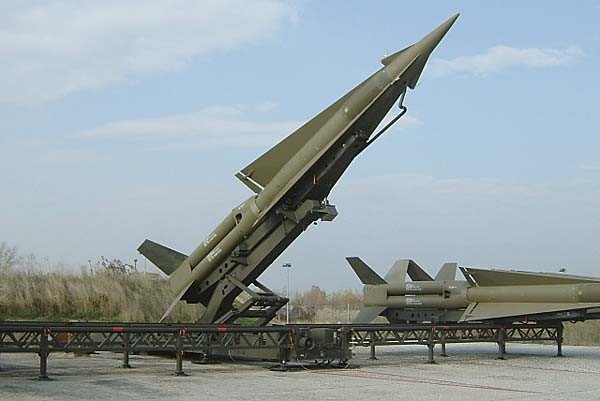

After the next row of my service ribbons, I'll have a Nike Nuclear missile on my left forearm.
I still have details yet to work out....
Like my unit Crest on the tail fin, etc....
Yeah, I once hugged this weapon and provided security and, well, never mind.
My tattoo artist is good......
