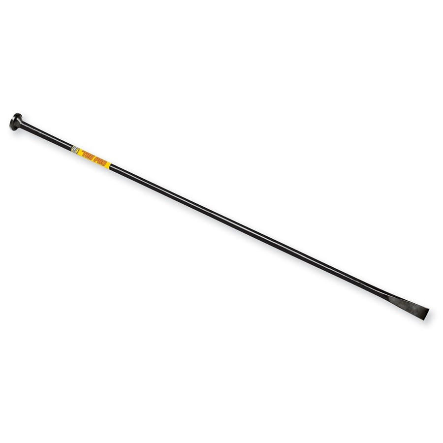

I would toss that piece of pipe with the cap and get a dig
bar man . Cut it in half and you'll get the stamp plus a
chisel / pry tool to boot . Works good with the driver .
Truper Tru Pro 69-in Post-Hole Digging Bar

Takoda that is a great idea for a ramrod :headbang:
Harbor Freight sells a 68" 17lb one for about $25

Please don't take this the wrong way but I'm thinking a longer ram rod with a smaller diameter head will be much easier to operate and actually make shorter work of the crushing.
Just try one like Takota suggested and see the difference. It wont matter that the diameter of the cylinder is a lot larger than the head of the ram rod. It's the weight of the rod being concentrated into a smaller area that will make it crush hard rock so much easier.
You could cut the tip of the chisel point off of one of these and try it: http://www.harborfreight.com/18-lb-pinch-point-bar-95971.html
It's amazing the crushing power that a solid steel rod produces when dropped on it's end.
