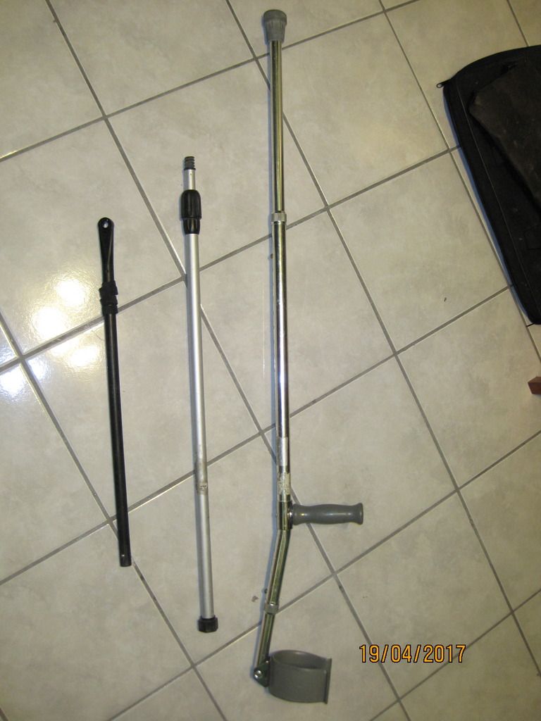

Guys I know it has been done but no one has post step by step or clear photos or instructions

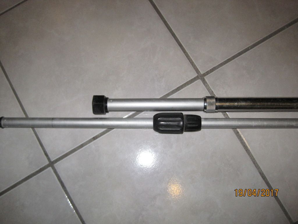

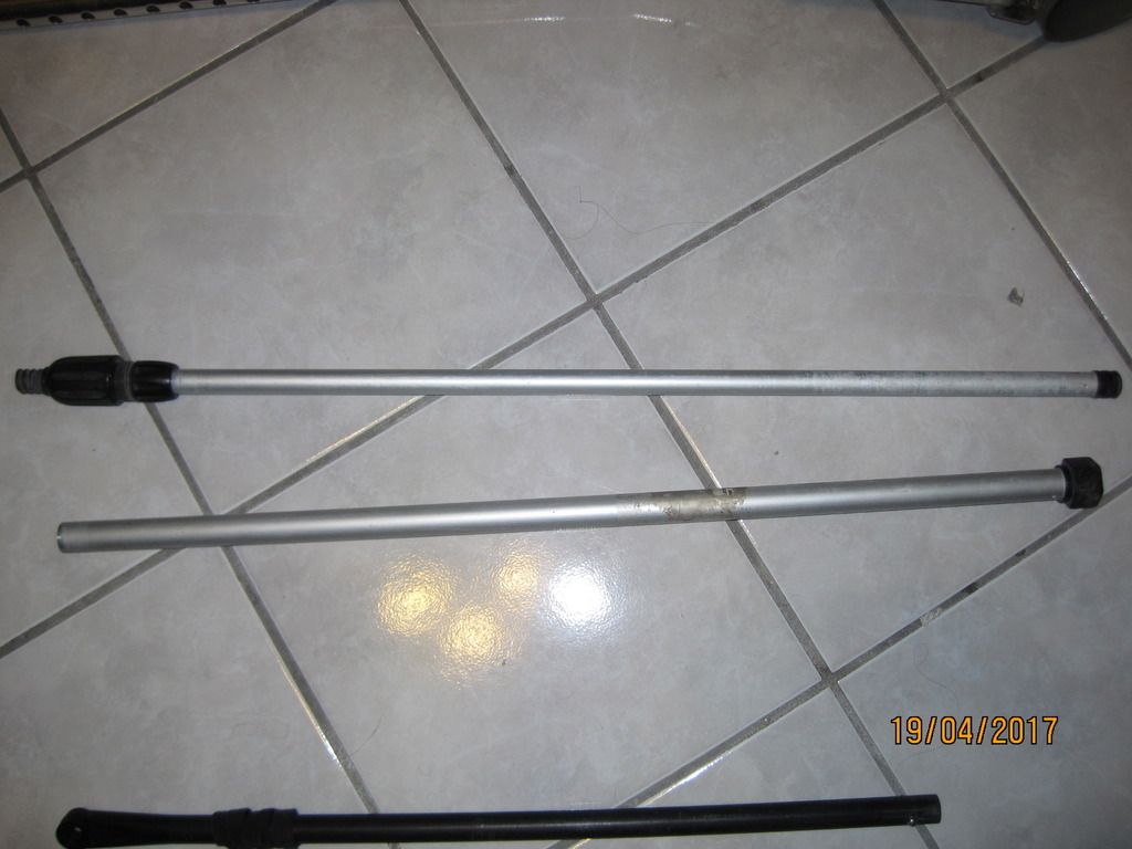

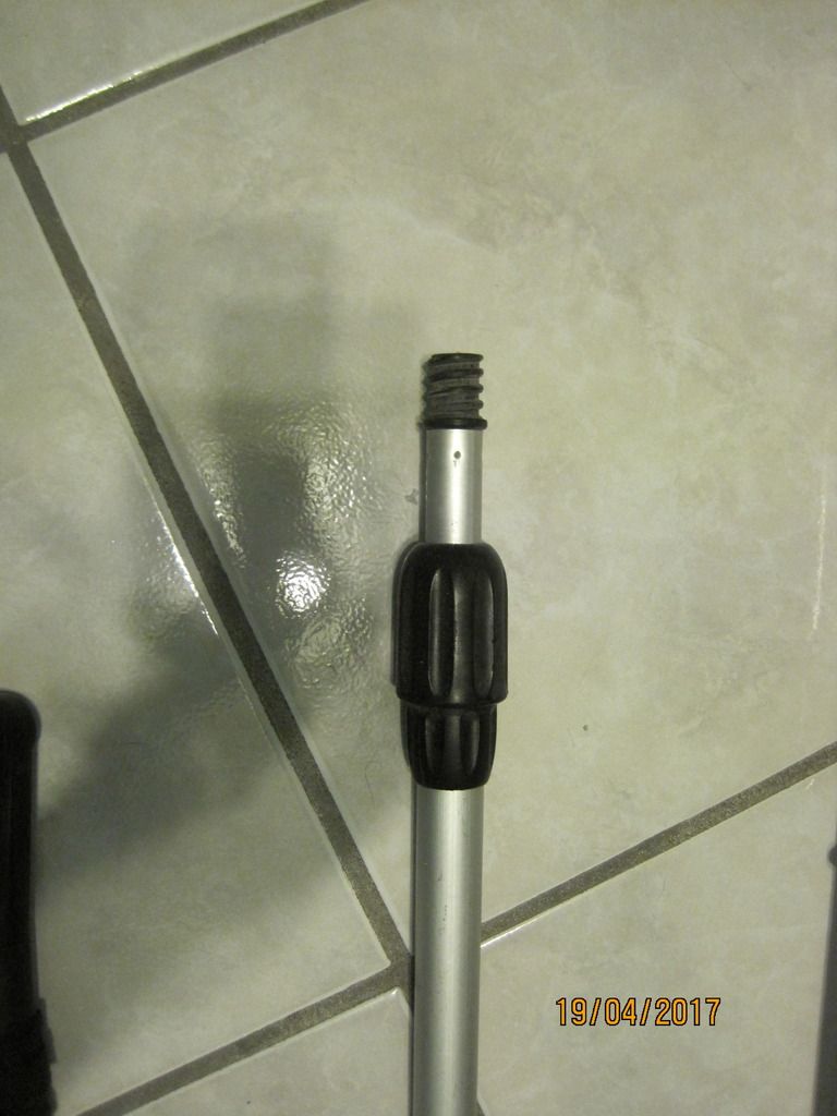

pole from a electric broom

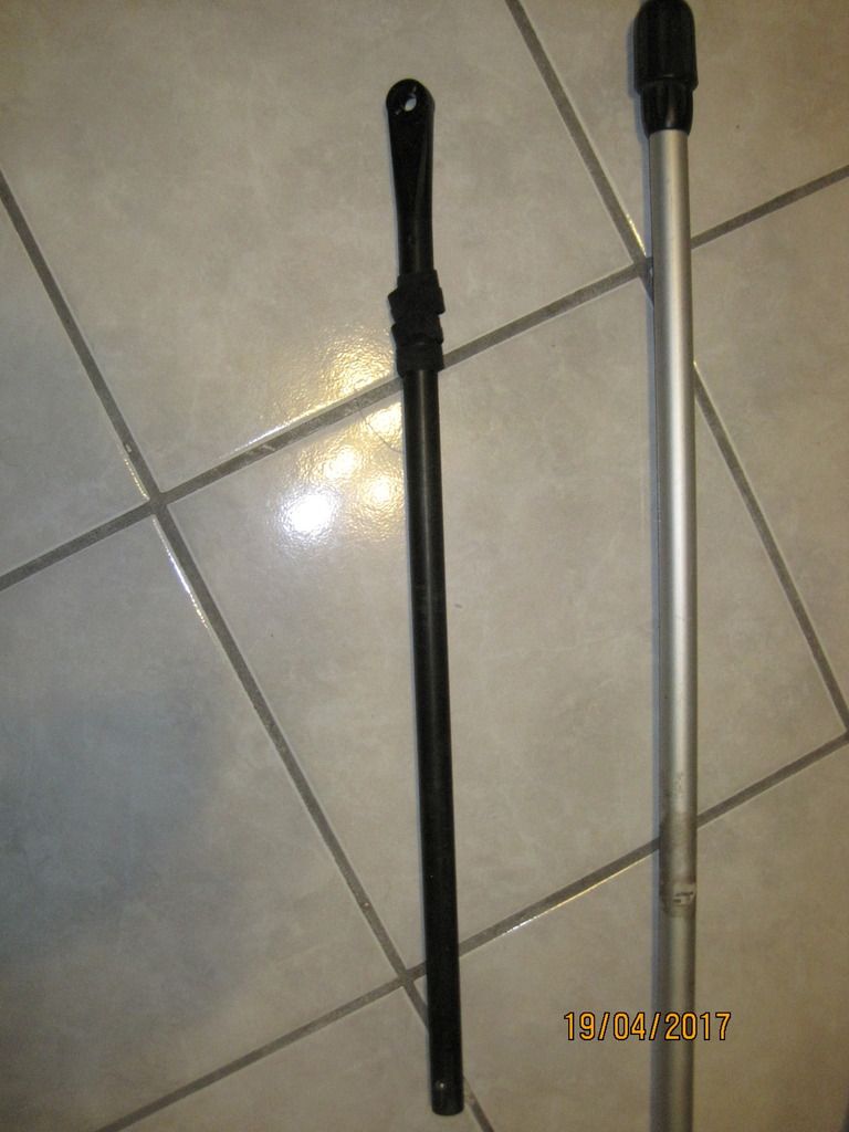

lower plastic shaft from whites
I used the broom because I need a sleeve that has a 7/8 diameter the shaft is a 3/4 diameter just like the stock diameters of most of the shafts

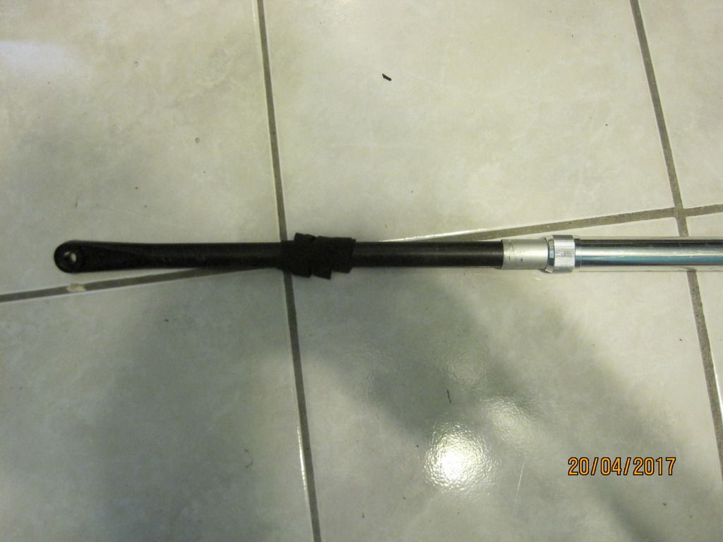

fully insert the 7/8 shaft inside the crutch
cut and leave 1 1/2 inch out
this is how it looks almost finish

no wobble! cant wait till my cz6 arrives!
