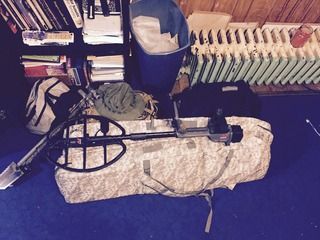

I only have a couple hours coinshooting on the CTX 3030. I am heading out to VA tomorrow for some CW relic hunting and would like to at least give the CTX a shot while I am there. (I am also taking my F75 LTD and AT Pro) and tips or tricks from the CTX users would be greatly appreciated.

If you are going to the hunt I think you may be attending, the solis there are going to be very hot. You will want to enable ground balance and ground balance very often. Since I see the large coil in your pict I'll mention this: Due to the mineralization, the large coils don't seem to work as well as smaller ones... They "see" too much mineralization which further hampers performance. The better coil would be the stock coil or even better the Coiltek 10x5...
Just about everything that is buried below about 5" will sound like iron in that soil... So you need to be prepared to dig everything.
