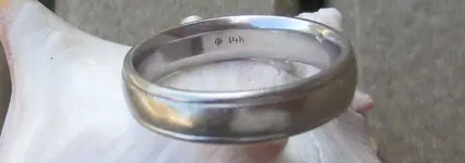

I hunted the other day with the CTX some in the water and some in the wet sand. I found nothing special. This beach is popular for swimming as well as metal detecting, So I was not surprised with a few dollars in change. I knew the battery was low and would need to be charged so when I got home I rinsed the detector off as usual with the hose and particularly hosed off the battery connection because I did not want any sand or grit getting on the O-ring when I took the battery off to charge. I did NOT hit it with a hard blast of water but did specifically rinse that area. I let the detector sit over night to dry off before removing the battery just so I did not get any water dripping into the battery compartment. When I removed the battery the next day this is what I found inside: CTX water leak 003.webp
Needless to say I was shocked. The battery was just as ugly looking. I carefully cleaned everything with electronic cleaner, paper towel, tooth brush and cotton swabs. The gunk came off but the terminal has been corroded. I assume water got into the housing when I GENTLY hosed it off. I was disappointed. I love the detector but BE CAREFUL when you wash it off, it apparently doesn't take much to breach the seal. I cleaned it, dried it, charged the battery, (I was amazed that it took a charge), put it all back together and it worked fine. Perhaps since the battery was so depleted already that it did not eat the terminal completely. Now I am not recommending anyone wet the internals of their detector as I did, but when I took it hunting today, it produced 4 rings and a bracelet for me. Beach Treasures 003.webpMore goodies than I have gotten on any other hunt this year. One 14k gold at 9.6g, one silver band, one silver band with pearl and one Titanium not in the photo, since I found it for a guy on the beach. He was delighted with the return and showed his appreciation, which bought gas for the next few hunts at the beach. Happy hunting to y'all and do be VERY careful when you wash your CTX. Papa
