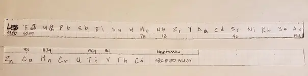

Hello all, had some XRF Scans done on some of the rocks I had to see the elemental compositions of them. Any help to point me in the right direction would be great. The 'UNKNOWN', is for both Specific Alloy and the Geo Standard of known compositions. Thank you for the help,
Edward M.
Sorry LE% is for the Light Elements.
Edward M.
