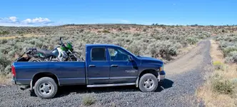

I've owned my 2005 Dodge diesel 4x4 2500HD since new. Now at 75,000 miles.
Best average mileage: 24-25 mpg not towing (freeway)
Towing: 13-16mpg (about 11 to 12,000 lbs)
This mileage is for the Pacific Northwest (up and down mountains). Flat-landers get much better. To date I've only replaced the shocks and two front wheel hubs. Current Blue Book is $24,000 and I paid $31,900 seven years ago.
You do the math ! :headbang:
