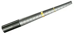

I think this is what you need. I have had mine for many years.
It is a tempered steel ring mandrel.
It is tapered, so is your ring. Put the ring on backwards and hit with your mallet the same way you made the ring. All the pounding you did hardened the silver. You could heat treat it with a torch to soften it and make it easier again. Just watch the heat, too much and you have a puddle. >:(
