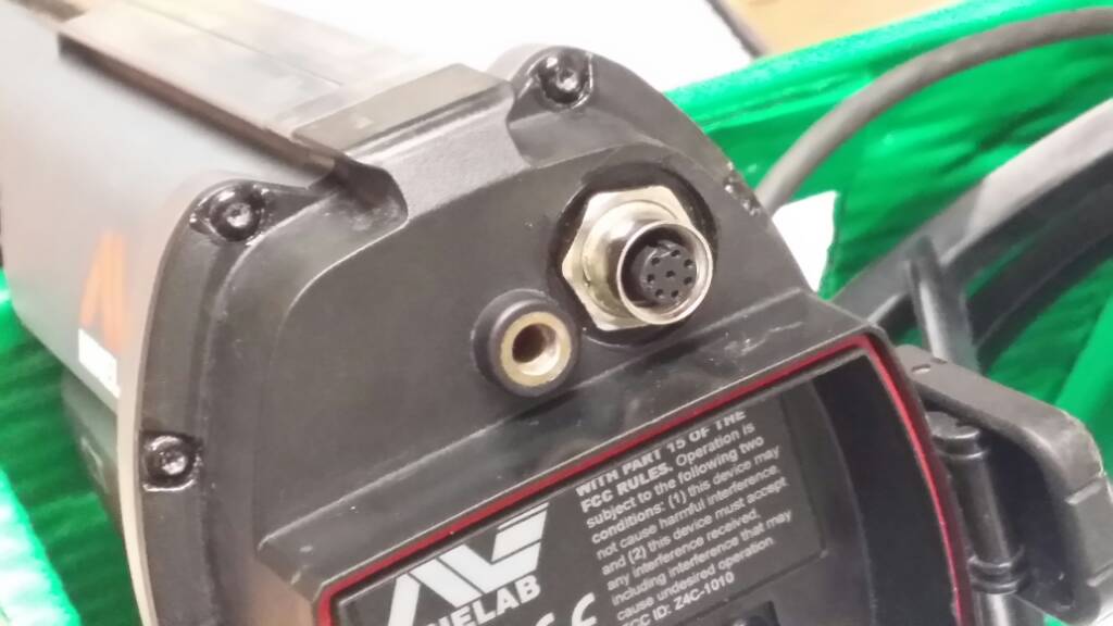

Thus far o-ring replacement for battery pack, USB port, and more recently the coil connector have been discussed for CTX water hunting.
Is there any issue with the ear phone plug?
1/4" one with adapter is not waterproof.
Need waterproof headphones with the M12 8 pin connector. Need to make sure it is tight.

The machine includes a headphone adaptive module for use with the standard headphones with the 1/4" male connector.
These are not meant for uses in the water. Module will mate with the M12 8 pin connector on the machine and keep water out of the detector but water can get into the female 1/4" connector used in the module.
Wait....so the stock headphones for the CTX shouldnt be used in the water? I havent used mine at all yet because of the heat...but is that true?
They are not waterproof and neither is the headphone jack module, if you remove the headphone jack module you will see the connector where waterproof headphones are to be attached by screwing them on...
If you want to hunt in the water, you either need to do one of three things:
- remove the headphone module (the piece just above the battery) and install the plug over the connector in Treasure Hunter's photo and use the speaker
- use one of the water proof headphones made for the CTX Minelab Koss CTX 3030 and GPZ 7000 Waterproof Headphones or Detector Pro Grey Ghost Underwater CTX 3030
- or plug the connector as mentioned above and use normal headphones with the wireless module - assuming you can keep the module and your headphones dry, AS THEY ARE NOT WATERPROOF.
Like Jeff mentioned, you can change the plug on your favorite pair of headphones but you would be limited to using them with the CTX 3030 only... and chances are they are not submersible anyway.
