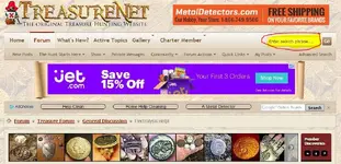

Going forward just type a keyword for what interests you up in the "enter search phrase" box
It's so easy and that's how I mined topics that interested me when I first became a member and mainly lurked.
