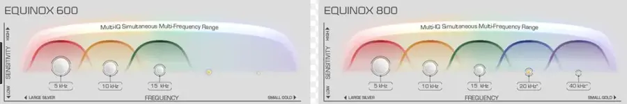

I dont believe this is true according to this diagram:
Not only true, it is fact, you can take it to the bank, when in Multi-IQ they are identical in frequencies used, 600 only limits the selectable frequencies, it changes nothing in Multi-IQ, your mixing up selectable frequencies with Multi-IQ
From Minelab Website.
Multi-IQ Most of the confusion I have seen online revolves around Minelab’s new Multi-IQ simultaneous multi-frequency technology and the frequencies employed by the two detectors. The EQUINOX 600 is limited to 5 kHz, 10 kHz, and 15 kHz single frequencies, while the EQUINOX 800 also offers these plus the additional higher frequencies of 20 kHz and 40 kHz. This does not mean that the 600 is not employing the full multi-frequency range as part of the Multi-IQ processing. Multi-frequency operation is identical in the two models and provides the same maximum signal response to targets in Park, Field and Beach Detect Modes., The real magic of EQUINOX is in the Multi-IQ technology (not the single frequencies), therefore you can rest assured the EQUINOX 600 matches the EQUINOX 800 in this regard.​

Wow, thank you for all that info. I feel much better about choosing the 600 now. Their marketing material is borderline misleading on this... it is only if you read the REALLY small print that you will find out that multi is the same across both platforms, and that it is only the single channel that is unavailable. I swear I saw a diagram somewhere just like the one below that only had 5,10,15 highlighted. Cant seem to find it now, so maybe I just dreamed it :):
EDIT: Found it, but cant find it on the Minelab site. Maybe they removed it due to confusion. If so, good on them
If you click on my link it shows it on Minelabs site.
Ahhh yes. They should definitely remove that then lol. I was half tempted to cancel my 600 and order an 800 last night when I was all confused! Could barely sleep!
