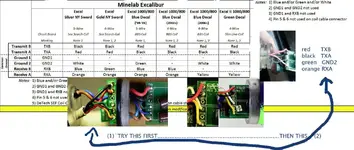

If your on a budget it's not real hard but not for the weak hearted. Will cost you about 30 dollars to do yourself..
The older coils use the 5 wire and the newer the 4 wire...
Lower end
upper to pod
Here is one done by Mel Parker, I love the yellow ..
Thank you for that OBN, The breaks in the jacket are along the length of the cable ( just found 3 more ) but the connectors are fine. I was thinking of cutting the cable off 6 inches from each connector, splicing in a new cable, then sealing it with heat shrink. If all the cable is suspect because it is old, it may be best just to replace both cables and be done with it. What do you think?
It is best to have it professionally repaired. I also have the older blue and had an Excal II. I think the Ole Blue was deeper and more sensitive. Maybe mine was just blessed.:thumbsup:
I have done similar for a temp fix, it just seems in time that gives away also. If you can swing the 300 I would go that way with Kellyco. If not I am here always and Happy to answer any questions that you may need. Even a phone call if you need. If you do splice the cables I used rescue tape a long with aqauseal to fix them. I think the last patch job I did lasted a few months...it was my own and a patched on a coil connector...
