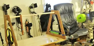

A few test I ran back in 2010 I believe...
Targets.. All 14k, small band 3.7grams, Med Band 4.5 grams, Larger Band think it was close to 6 grams, then a US Nickel
Air test results, Excalibur Blue and Excalibur II's, Stock coils, 800 and 1000
And the test rig

Nice test rig Joe. I like it.
Thanks Frank, Hope your well my friend.

And the test rig
Love the test rig! I can see the last two entries of the test chart
Were 800 and 1000 blue logo. Cannot read the first 3 entries
