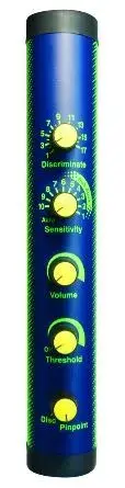

Hi i bought an excalibur II yesterday, went down to pick it up, guy shows me it making a noise on wifes ring we buy, he unplugs, put it in car bring it home plug it in ....nothing i cant get it to work. Now i have charged it and tried again again....still nothing. What in the world could this be please as i don't believe it simply decided to pack in on the journey home, somethings not right here. All help much appreciated

To be precise and specific, you still haven't said "what" he unplugged. Did he unplug the battery pack, or something else?
Excalibur is a fantastic detector which is why I own 2 of them. You need to be more descriptive on what it is doing and what he did when it was working. Tells us where you have the settings set at.
Where is disc pinpoint set?
Where is threshold set?
Where is volume set?
Where is Sensitivity set?
Where is Discrimination set?
Does it make any sound when you turn on the threshold which is what turns on the detector.
Volume should be set at max.
Sensitivity set to where it is stable.
NO discrimination.

Yea you need to turn the machine ON after you plug it back in.
If he unplugged the ikelite on the battery and you plugged it back in wrong then there will be a problem. Hopefully it is simple, always pay close attention when plugging the ikelite in..
Take a couple pics or a video showing how you set it up. That could help.
