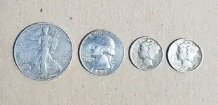

Another update. I went to Memphis this weekend and hunted with tabman. After finding a couple of silvers with the E-TRAC, I switched to the F44. Here are the 4 silver coins that I found with it.
