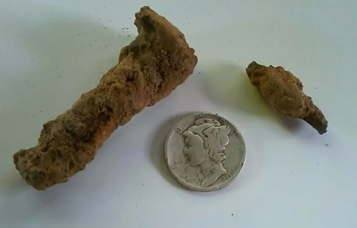

For about a week I used this setup and on three consecutive hunts I found three great silver targets in three different areas I assure you I have hunted to death.
The first was a silver rosie, not super deep at about 5" or so but in the hole with it was a rusted disc that I believe was a steel war cent and a pretty decent size piece of iron slag.
This was one of the entrance areas to a park just up the block from me that I practically live at.
I know I had been over this area a ton with different settings, coils and detectors and this thing never showed up before.

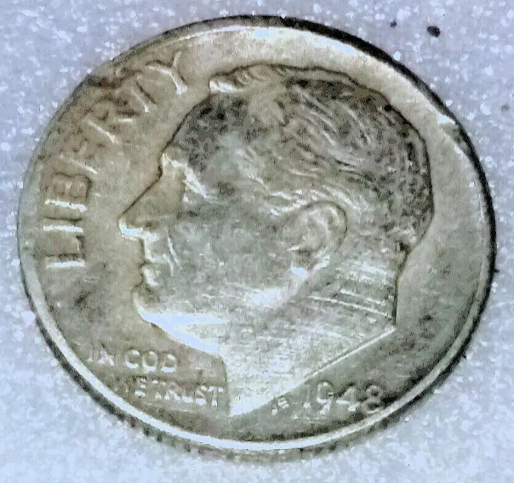

This time I got a for sure dig me signal and it shocked me when a silver dime came up.
This wasn't super stable, it had that iron in the hole, but I have learned indicators to target non ferrous objects in this mess and this time I saw them where I never did in the past.

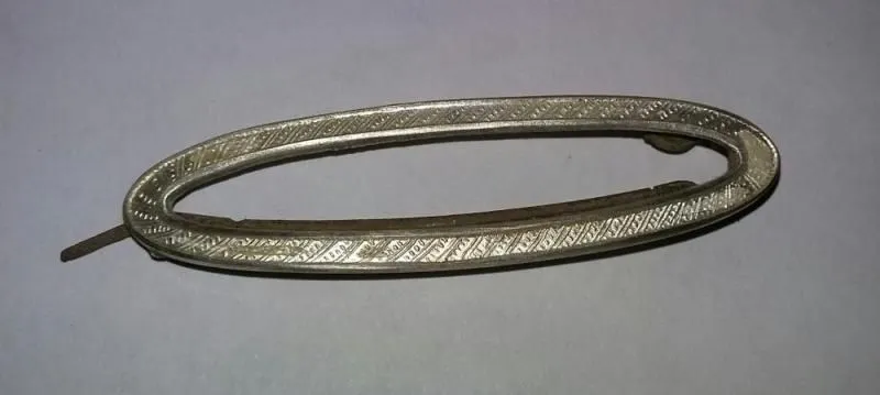

This time with these new settings I got another signal in an area right next to a walkway that I had been over a zillion times before and never saw...more dig me non ferrous indicators that I would have gone after for sure if I had seen them in the past.
I dug down about 5-6" and on the way pulled out a couple of healthy sized pieces of iron.
Finally at the depth my F70 said it was I pulled out something else...a large oval hair clip that came up suspiciously clean.
I knocked the dirt off and looked at the back and sure enough there was the word sterling stamped into it.
I was dumbfounded.

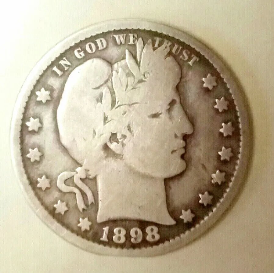

I was moving along and got another great signal, short but sweet.
My rig said quarter and not deep at about 2" but still I was surprised I had never acquired and dug this one before.
I opened a small hole and dug down but missed it.
At least one piece of iron in that hole, a big ol rusty nail, and nothing else in the bottom but my Propointer says dummy, it is in the sidewall of the hole, pay better attention when you pinpoint.
I stuck the tip of my Lesche in high and gouged out a chunk of dirt and pulled it it and threw it on top of the pile of dirt I had already taken out if the hole.
In that dirt I saw something cool, it was covered up with dirt but one edge was poking out a little and I saw it was shiny, not dark like all my clad looks coming out of my dirt.
It had to be silver and I was happy, I picked it up and cleaned off the face expecting to see Washington's bust or that familiar eagle but instead I saw a liberty head and went into shock.
It was a Barber quarter and the Date was 1898!
This is the one in my avatar, at the very tip top of my bucket list was any Barber because I should have found one way before this but never did and a quarter to boot.
I believe this thing was standing straight up and vertical, hard to believe we all missed this shallow coin all these years but that bit of iron near it and the vertical position might have had something to do with it.

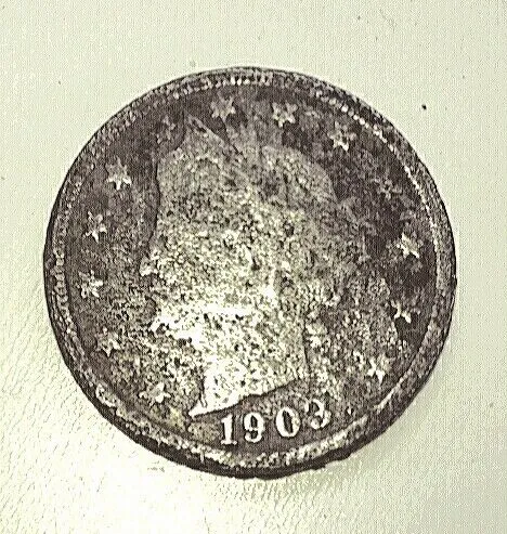

Then in an area near a very old building that had been here from probably the early 1900's I came across another really short quick but solid sounding nickel signal in the 3 tones I had just switched to for a change.
Heavy amount of red clay here just under the grass, a bunch of rocks too and even though there has been extensive work done in this park in the last few years I don't think this particular area was touched.
This nickel or whatever it was wasn't deep, turns out it was just below the grass at about 1/2" deep but again standing straight up vertically...hence the unusually short tone.
I went for it and when I got it out of the roots of the grass it was entangled in I again was shocked...this wasn't a Jefferson as I expected or even a buff, it was a freaking V nickel with a date of 1903!
Only found 4 in my career and this is the best one yet.

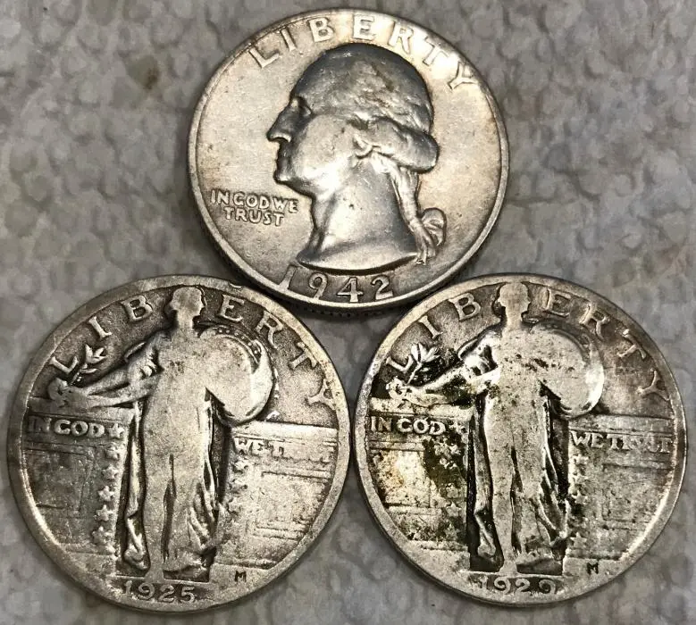

Just to remind you about these settings I have recently suggested the same to a friend up in Ohio because, well, they work.
I am mentoring him and he is not into tweaking and experimenting much but he will take specific settings I give him and use them enough to get good with them.
Recently he used this high thresh-disc-gain method and in a small park he has hunted a lot he came across the best signal of his life.
In his great Ohio dirt they worked well.
He uses an F70 and an 11" DD coil mostly.
Disc maxed at 65.
Gain as high as you can go without much noise.
Thresh up there too, I usually push it to between +6-+9 F75 guys don't worry about this one because you can control the thresh in disc.
Monotone.
DE.
Surprisingly quiet with the disc that high in monotone despite the maxed out gain and thresh.
Adjust it down a bit if too much noise at any site.
Depth reading on this signal said 8" and he found a silver quarter there.
VDI numbers jumped a bit from 84-91...but there was a reason for that...this ended up to be very accurate even that deep.
The reason for that jump is after he pulled out that silver Washington his pinpointer says there was something else a little deeper.
He stuck his hand down there and pulled out a clump of dirt and when he looked through it there were two more targets in there...two SLQ's.
He never dug an SLQ before, never found a silver coin spill or even 3 silver coins on one hunt either so he is flying high on this one.
A rare find for any of us plus he had dates on both of the standers so a bonus.
Try this method sometime, couldn't hurt but it may work for you too.

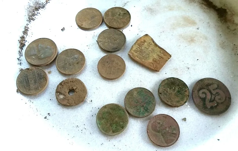

I used these same settings today in a lawn I have been hitting hard and now is starting to dry up
Most everything you see in this pic came from there except for a couple which I got from another area in a park I have scoured for over 2 years using the big DD coil.
99 on the sense and + 9 on the thresh most of the day but there were times I had to bring it down a bit because of extra chatter from WiFi or something.
The quieter it is the more the good signals stand out so even though I can deal with tons of noise and chatter I still notice things easier in quieter environments.
Most of these targets were really quick so if I wasn't on my toes and moving that coil real slow I would have missed them.
One old wheat at 5-6" with some kind of huge iron deeper under it was real quick but my sense at 78 and thresh at +6 on that one so the good tone stood out from the high tone falsing i usually get around all the iron I hunt in...even in these lawns.
Adjust as you see fit but I think the high disc is the important thing here, plus monotone and the thresh is too if you can adjust it higher and the gain level brings up the rear.
4 older wheats going back to 1919 three of them green, my oldest dog tag from the 50's, a tax token and some sort of cool old token that only has that old script number 25 on both sides.
I have no idea what is going on with that token but it seems old and it is cool.
Missed most if them in previous hunts but today, with these settings, it was easy.
