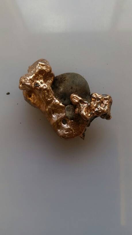

I knew an older electrician who was also an avid fisherman.We did a thing called cad-welding, whcih was used to weld big cables. Anyway, sometimes the molds would leak a little molten metal.Sherm would save the good sized ones that looked like nuggets. And when he would be fishing, he would drop the 'nuggets" in the stream were he knew another fisherman would see it. then he wuld move on a little and just watch. On more then one occasion, he would see a firsherman find the :nuggets", grab them, look aroudn and take off!
We do a lot of cad welding, and this is spot on, sometimes the leaked metal looks very nugget-like. The color can be almost spot on as well depending on the temperature the moltem metal was at before cooling. Here's a pretty good example of a 'nugget' from a leaky mold. The color is off, but other than that....if you saw this sitting on the bottom of a stream bed in gold country...
